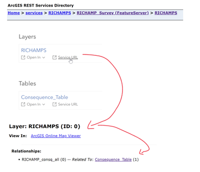

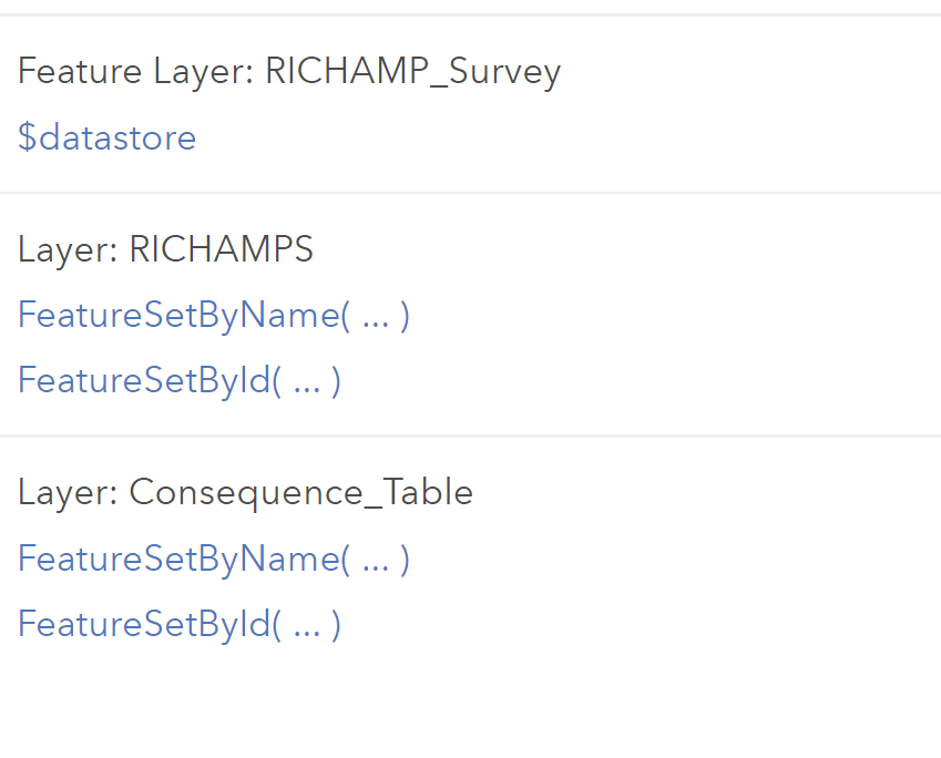

I am new to using expressions and arcade with popups and I am finding I am pretty lost going through some of the other posts. I have a related table that using parent global ids and I want to display those attributes in the related table in the popup. When I am expressions window to create a new one, I find the related table under the Feature Layer (the main data in is the RICHAMPS layer, and the related table is Consequence_Table as shown below). When I look under the $feature section under the global tab in the expressions windo, I do not see the related table at all. Therefore, I am getting confused, because I think I need to replace $feature with $database in some of the examples I have seen?

Unfortunately, I do not see related records at the bottom of the $feature section.

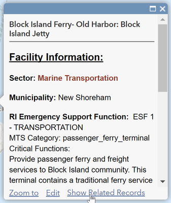

This is weird because I know they are there as there is a link to table in the pop up as I have the "show related data" checked in the configuration.
Hence my main confusion. I have related records but something seems to be off to configure expressions?

Strange! Well, are you still able to use the "FeatureSetByRelationshipName" function? The relationship name tends to be something like <source layer name>_<destination layer name>, but you can find it in the service's definition on the REST directory page for your service.

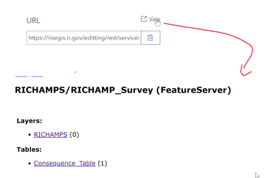

So I cannot see the "FeatureSetByRelationshipName" function, and I think this has something to with how this service is set up (I forget to mention that I am working with ArcGIS Enterprise).
I didn't do this part so my tech speak may be off, but I believe everything was set up on the server:
