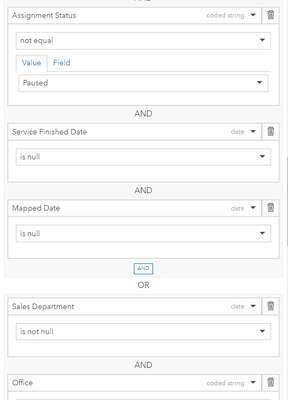

How do I write a filter statement in arcade in field maps for grouped fields?
Assignment IS NOT NULL AND Service_Finished_Date IS NOT NULL AND Mapped IS NULL
OR
Sales Department IS NULL AND Office IS NULL

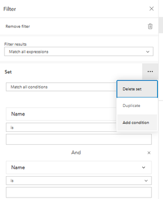

neomapper
Does the new Map Viewer not support the classic filtering options for "adding a set" ?
jcarlson
MVP Alum
It's a little more hidden. You have to click on the options for a condition and select "add condition".
- Josh Carlson
