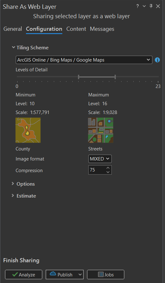

Hello! I just had this problem and tried a few different things to no avail.
What has seemed to work in the end is sharing the raster layer as a Web Tile layer and then on the Configuration settings, ensuring that ArcGIS Online Bing Maps / Google Maps is selected.
DebapriyaPaul
Hi @abrown8 , thank you for posting this question. Great suggestion by @FloraTiley. Using the same tiling scheme as ArcGIS Online basemaps would allow us to add the tile layer as an operational layer in the map.
Additionally, if we want to visually overlay an image in a web map and have control over enabling or disabling the visibility, we could also use the Add media layer workflow.
