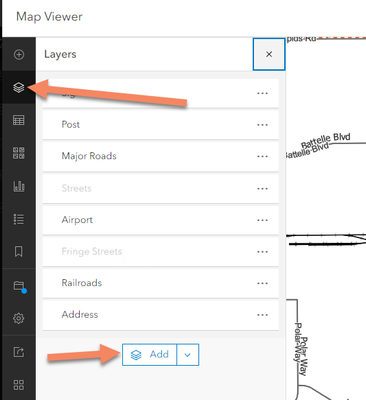

In Map Viewer, make sure you select the Layers icon, then select Add:

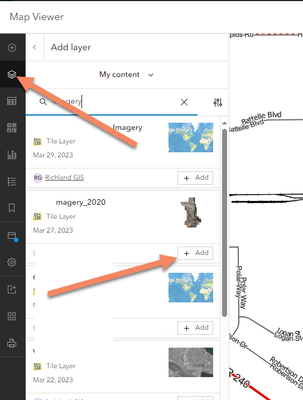

Once you find the published tile layer, you can click the + Add button:
which should add it as a data layer, not a basemap.
