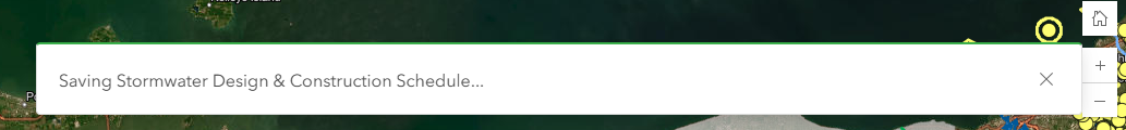

Is anyone experiencing issues saving edits to web map viewer in ArcGIS Online since the update on Wednesday? I am encountering this with several maps after trying to add layers, change symbology or field information, I am unable to save - the little green bar just stays at 100% and never changes.
I am also not able to save it as another map. The option is available, but nothing happens when I click on Save As.

@StephanieW Thanks for following up. Yes, I am still having this issue with at least 2 maps. When I try to save my edits, the little green bar never progresses, and if I close out and come back in the edits are not there. I am the owner of the maps, and have had 2 co-workers who are admins also try to edit the maps and the same thing occurs. I am able to edit at least a couple other maps successfully, and was able to create a new map. In one of the maps I am having issues with, I removed each layer one at a time and tried to save to see if a specific layer was causing problems, but had the same experience each time I tried to save.

@StephanieW We think we have identified the issue - when we remove our nearmap imagery from a webmap we are able to save it and forms are showing up. We have been having issues with nearmap since the update last week and have a ticket open for that already. Thanks for your assistance.

Hi @LJackson29 Thank you for letting me know, I am glad you are able to save your web maps now. We are working directly with Nearmap to have BUG-000180349: Authentication issues occur when attempting to access Nearmap US Vertical Imagery services resolved as soon as possible.
