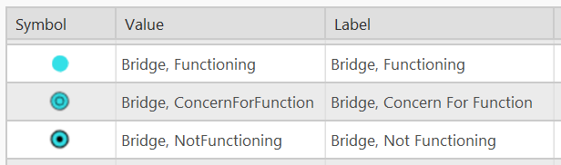

Though I would prefer no field values to change at all, this would not cause a big problem, except for some layers where I use a symbology based on multiple fields. For example, in a different feature layer in ArcPro, data points with a structType value of 'Bridge' and a structCondition value of 'Functioning', 'ConcernForFunction', or 'NotFunctioning' are represented as shown below:
In ArcOnline, the structType of all of these points becomes 'Bridge, Functioning' instead of 'Bridge'. The structCondition field values are not affected, so, e.g., a data point that in ArcPro originally had {structType: 'Bridge', structCondition: 'ConcernForFunction'}, now has {structType: 'Bridge, Functioning', structCondition: 'ConcernForFunction'} in ArcOnline. This is now a problem, as it makes viewing the data confusing.

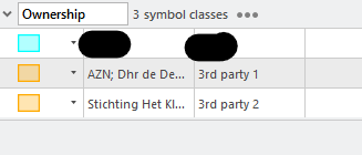

setup symbology in Pro, unique values on ownership. Grouped separate symbologies:

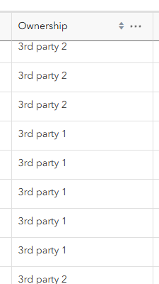

Published to AGOL, records in AGOL attribute ownership. the actual data in the field is lost and overwritten:
