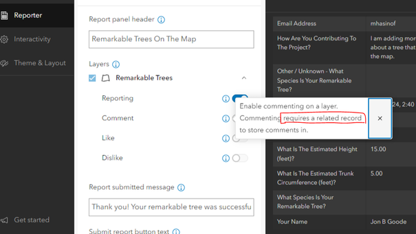

Sharing and editing on all layers have been enabled and I have created fields with appropriate string and numerical field types for comments and likes, but STILL, I cannot enable (toggle) the Comments and Likes in the Reporter App. Any help would be appreciated!

@mhasinoff  Your Comments table must be a related table - with a relationship published from Desktop/Pro.

Thanks for the help. It got me going in the right direction. I used a separate standalone table to store the comments. This set of videos was helpful: https://www.youtube.com/watch?v=HYrS34WUnn4

I am also having trouble with this. Even after following the videos from Esri Canada, I still can't see my numLikes or numDislikes fields offered to me.

I was unable to enable the Like and Dislike options until I changed the Data Type of my feature class from Double to Short. After overwriting the layer from Pro, these options are now available in the Reporter builder.
