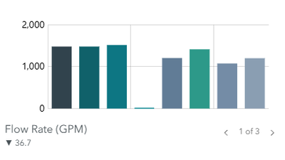

BlairMcclenathan
AJ,
Below is code I have used to pull from historic hydrant flow tests (in a related table) to display flow and pressure data as a bar chart.
       var MAX_TESTS   = 10;

    /* ─────────────────── 4. Assemble the charts ─────────────────────── */
    var colors = [
      [48,67,77,255],[8,97,107,255],[0,118,132,255],[0,140,153,255],
      [96,124,151,255],[39,153,137,255],[115,140,167,255],[137,158,179,255],
      [161,178,196,255],[188,206,221,255]
    var charts = [];
    if (Count(flowFlds) > 0) {
      Push(charts,{
        type:'columnchart',
        title:'Flow Rate (GPM)',
        caption:flowCap,
        value:{fields:flowFlds,colors:colors}
    if (Count(resFlds) > 0) {
      Push(charts,{
        type:'columnchart',
        title:'Residual Pressure (PSI)',
        caption:resCap,
        value:{fields:resFlds,colors:colors}
    if (Count(staFlds) > 0) {
      Push(charts,{
        type:'columnchart',
        title:'Static Pressure (PSI)',
        caption:staCap,
        value:{fields:staFlds,colors:colors}
    if (Count(charts) == 0) { return; }
    /* ───────────────────── 5. Return Chart ──────────────────── */
    return {
      type      : 'media',
      attributes: attrs,
      mediaInfos: charts
