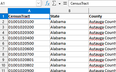

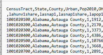

I stand somewhat corrected. The CSV they provide has the 0 trimmed off already! Sounds like a bad export on their end. The XLSX, on the other hand, does have the leading 0 on the tract ID field.
Excel file:
Raw text of the CSV:

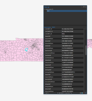

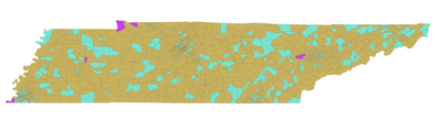

The join works just fine. Here's TN, symbolized by one of the Food Atlas fields:
And in Pro, too:

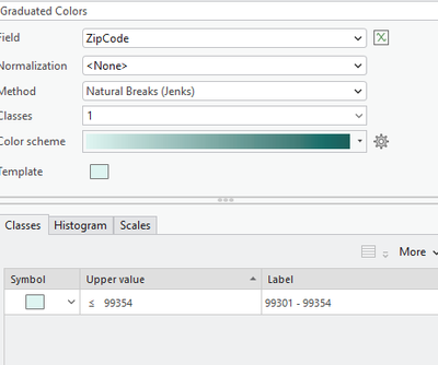

I am having a similar issue over here in SE Washington state... I need to map out 2023 Life Expectancy by Zip Codes for our Community Health Assessment. I am using 2020 Census Tract data (includes the GEOIDs and Zip Codes, does not include the 11-digit tract numbers).
But my csv with my Life Expectancy rates and zip codes will not join correctly with the Tract data. I'd like to use graduated colors in symbology to differentiate the zip codes areas by Life Expectancy rates. Symbology does not recognize the Rates column as quantitative and then I end up with only one class when I need 4 classes. A few things I have tried results it Symbology wanting to recognize the zip codes instead of the rates.
I did not realize how complicated working with Census data can be! But I'm not giving up!
