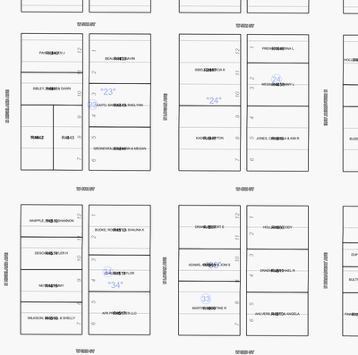

Hi, recently, as in the last month or so, there have been labeling conflicts on polygons.  I have a hosted feature layer, then 2 hosted views based off that layer set up for different labels in the web map.  Obviously, these features all have the exact same shape and extent, and therefore, want to label in the same spot (center of the polygon).  Previously, (I have had the exact same maps set up for several years), when multiple layers are turned on, only the top most layer in the table of contents would draw.  If multiple of these layers were turned on and had labels shown, only the top label would draw, then if you turn it off, the one under that would label, and if you turn off that, the main label would label.  Recently, however, the software is drawing all labels, overlapping, making a mess!  This has never happened before and I am interested in knowing what has changed and what can be done on Esri's side to rememdy the issue.  I am NOT interested in offsetting labels, that is not an option.  I just want to labeling engine to go back to how it was before and not allow overlapping label conflicts.  Here is a pic of 3 labels drawing right on top of each other:

You’ve described the change perfectly. This isn’t about placement tricks—it’s about label priority across duplicate/related layers. Up until recently, only the topmost layer’s label would draw. Now the labeling engine is rendering all labels from all layers, so you end up with stacked, unreadable text.
Unfortunately, there’s no way to revert to the old behavior—this is part of Esri’s new labeling engine. Developers have introduced deconfliction “strategies” (static, none) in the SDKs, but these options aren’t yet exposed in the Web Map/Pro UI. That’s why you’re seeing overlapping labels even when your scale ranges and symbology are set correctly.
