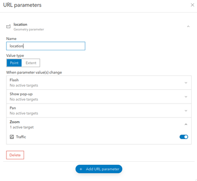

Go into your dashboard's settings to find the URL Parameters section:
You can refer to the Dashboard documentation to see the specifics on how a geometry parameter works, but basically it's just your lat/lon.
location=-75.6971931,45.4215296
