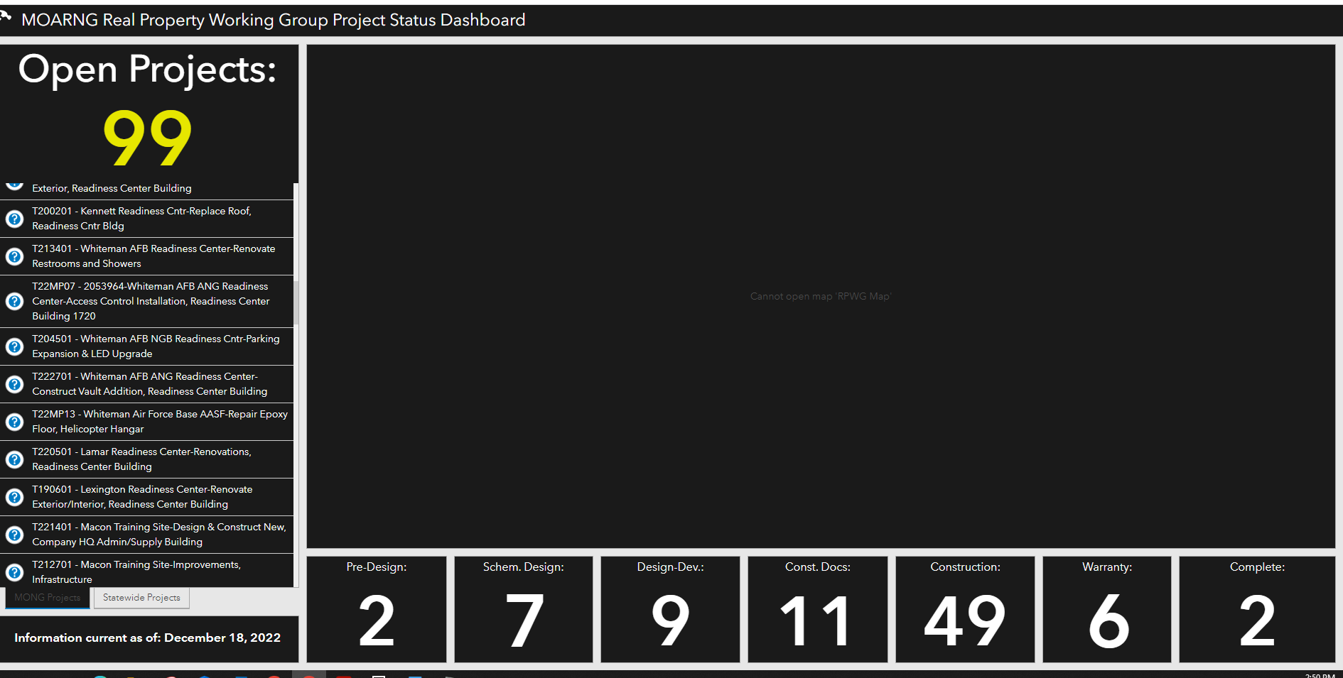

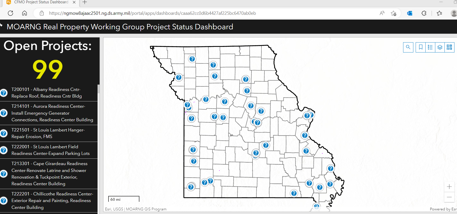

hi all, like the title says. I'm having an issue with my dashboard. The top dashboard is opened in Edge while the bottom one is opened in Chrome. I really have no idea what's going on. I recently overwrote the projects layer and maybe that has something to do with it?? Thank youarcpro_edge.PNGarcpro_chrome.PNG

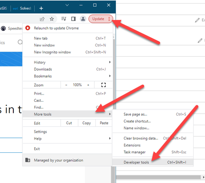

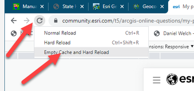

Could be a caching issue.  Could try this:
Open developer tools on browser:
While in developer mode, right click the reload button, select Empty Cache and Hard Reload:

Found the solution: go to internet Properties, click connections, and hit LAN Settings  and uncheck the box corresponding to use Automatic configuration script.
