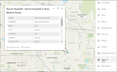

If you are using ArcGIS Online, you need to meet the following requirements to see the Analysis button in the new Map Viewer:
  • You have credits (I think 10 should be fine)
  • You have the correct privileges' (see: https://doc.arcgis.com/en/arcgis-online/analyze/licensing-analysis-mv.htm)
  • You must have a hosted layer in your org. I can't tell from the above if you've created a hosted layer in your organization. If you're not sure, please try and publish a hosted layer via Pro, or uploading a zipped shp or filegdb. Once that's been published, reopen map viewer and see if the analysis button shows up.
If you think you meet all three of those criteria, and you're still not seeing the button, please contact Esri customer support and they can work through it with you.
If you are using ArcGIS Enterprise, you won't see analysis in Map Viewer until ArcGIS Enterprise 11.2, as @MikeGarcia noted.
Thanks,
Sarah Ambrose
Product Engineer, Web Analysis
SarahAmbrose
We've created an FAQ here about why you might not see the analysis button in Map Viewer: https://community.esri.com/t5/arcgis-online-blog/faq-why-don-t-i-see-the-analysis-button-in-map/ba-p...
