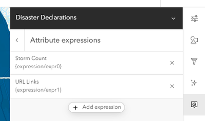

@Brian_McLeer - One way I have been able to do this by setting an attribute expression that is used with Text element in the pop-up.
Step 1 - Setting the attribute expression. Workout your conditional statements and the respective URLs.
example - I have used the below condition in the URL Links expression.
if ($feature.Dorian_2019 == "YES")
  return "www.google.com"
else {
  return "www.youtube.com"

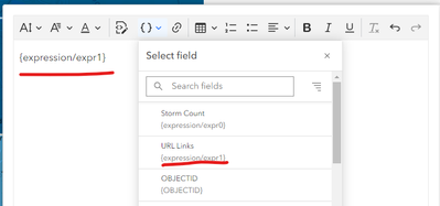

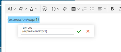

Step 2 - Add a text element to the pop-up.
Insert the custom expression as a hyperlink.

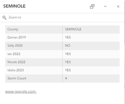

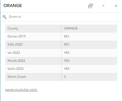

Results -
Hope this helps 🙂
