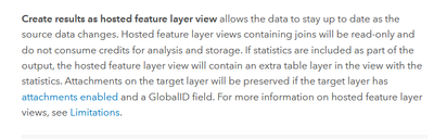

Hi Garrett,
Yes it will stay up to date, but just make sure you click the "Create hosted feature layer view" when running the join in the classic map viewer, as otherwise it will be static. I use that workflow for some of my projects too and it seems to work correctly 🙂
However the resulting live view layer isn't able to be made sync enabled and therefore cannot be used in the offline map unfortunately. You could run the join periodically and output a static layer that would be able to be sync enabled, but that would require automation and somewhat defeat the purpose.
