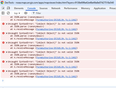

I have run into this same problem also, getting errors in the console when opening the form.

I would get that error if I was working in a new map or opening a form that I had created using the Field Maps Designer.
I was able to log onto a virtual machine and save the form, so it looks like something that's going on with my machine, not the account settings for ArcGIS Online.
