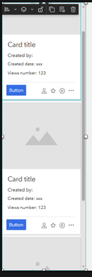

That makes it a lot easier to understand and work with. So there are a couple of ways to go about this but it is a bit in depth:
  1. Using Cards - This method is a bit more complicated but it is easier to manipulate.
    1. Add the column from the layout section. This will automatically organize your data into equally distributed and scrollable format. You can modify the cards to include any kind of button within the card or if you simply want buttons within the cards that can be done as well.
    2. RPGIS_0-1753188177207.png *Note: You can duplicate each card by clicking on the duplicate in the upper left hand corner of the card.
    3. Add the section widget to the layout and add whatever maps/widgets/etc. you need to that section.

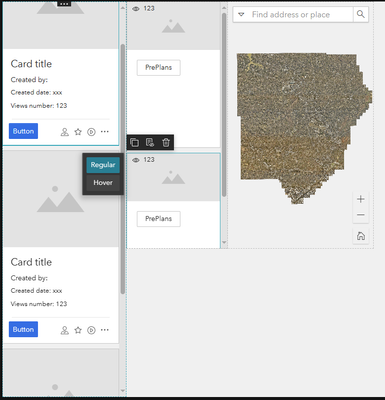

      1. *Sections are where views are situated if you were not aware of that. Clicking on the + adds additional views or the duplicate button to duplicate the same section once you have it built out. In your situation you can add cards within each view and have a query widget within each card.  Ideally you want to build the initial layout of any section/card/etc. before duplicating.
    4. Once each view is created, adjust each view to whatever specifications. Adjust the different query widgets, map layers, etc.
    5. Set each card to navigate to the different views using RPGIS_2-1753189254599.png and selecting the desired view.
    6. It should look and behave similar to the image below.
