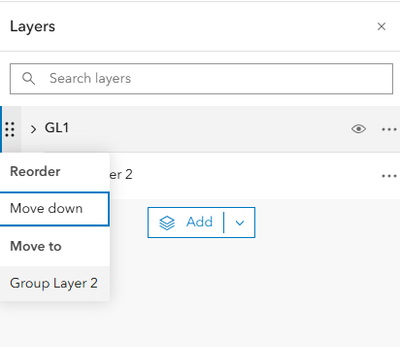

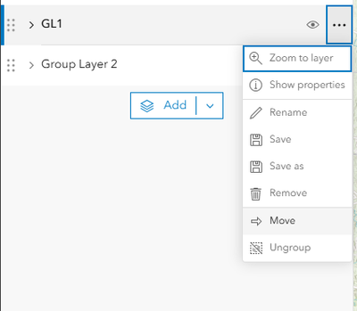

Were still having major performance issues with the new Map viewer, with the february 2025 update  you also have to scroll trough all the sublayers in the layer groups if you add a new layer to the project and want to move it down or up in the content pane. The map is being used in interdisciplinary project work with a lots of layers and sublayers, so this new bug makes it more difficult to maintain and update these projects. Opening the same map in Experience builder for some reason run much smoother

The expanding on the layer list behavior group layers is currently as designed but we have sent this feedback over to the team. You will also see this on Experience Builder with an app that allows reordering. You can also use the overflow action and select Move and pick the group or clicking on the drag handle will also give you the option to move to group layers.
We still have some performance updates on the roadmap for differences between the two if you can share the map I will take a look.
