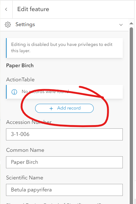

2. Create new record in Map Viewer using forms:

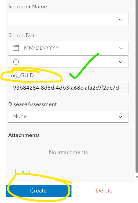

3. Form populates with the correct primary key into the foreign key field

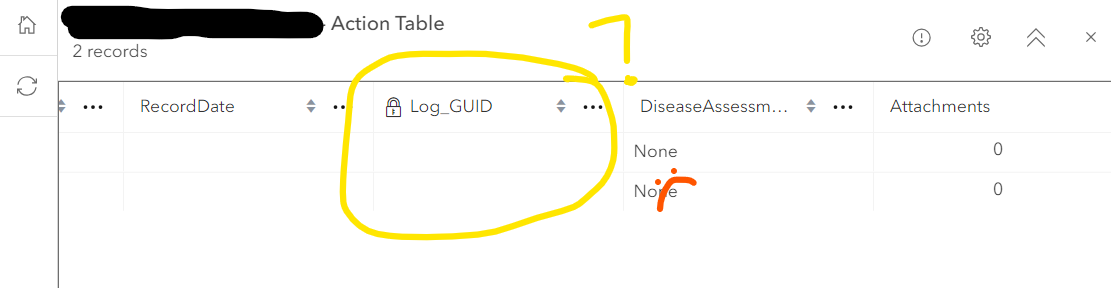

4. Data is created without any error but not related to origin layer. The primary key doesn't carry over to the foreign key.
Why is this happening? It seems like it's working fine until I actually submit the form.
