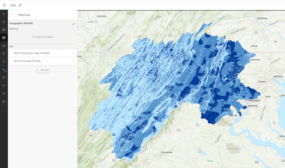

I have a map with three KML layers (all with the same web mercator projection). The coordinates lay correctly on the map in the Classic AGOL map, but then when I open them in the New AGOL map, the coordinates are off on one of the layers.. The same thing happens when I open it in Experience.
Also, the New AGOL map would give me an error when I tried to add any of the KML files to a map. I could only add them to a map in the Classic version. (maybe this is a clue...or coincidence?)
You can see how the coordinates are off for the Flashiness (blue) layer in the attached screenshot.
What could be making this happen?
Thanks for any insight!
-Renee

can you share the KML layer file causing the issue?
RenBou
Here is a link: https://arcg.is/5D1zP
I am a total ArcGIS newbie, so please explain things like I'm in 6th grade. Thanks! 🙂
RussRoberts
Esri Notable Contributor
Shifting looks to be a known issue in the JSAPI that both Experience builder and MV will present when loading a KMZ file as a KML layer. BUG-000115201
I am looking into why the layer is throwing an error when being added in MV.

Can you use a WGS84 offering of the basemaps? This fixes the offset issue.
