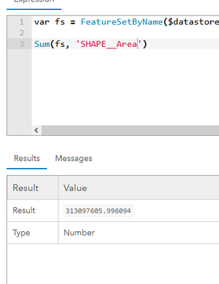

For something as simple as this, you can use the built-in function Sum(), which can take a FeatureSet and field name as parameters.
Also, since the "SHAPE__Area" field is an attribute, you can specify that field alone and skip bringing in the geometry in the FeatureSetByName function to improve performance.
var fs = FeatureSetByName($datastore, "PARCELS", ['SHAPE__Area'], false)
return Sum(fs, 'SHAPE__Area')
 That should return something like this:
