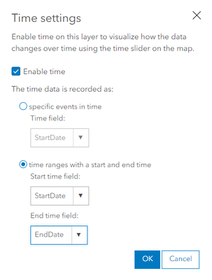

When you set your layer to be time enabled, did you select the option "Time ranges with a start and end time"?
If you set this up with your open and close fields, the time slider within the map viewer should then work as expected. As a reminder, you'll find these Time settings on the overview page of the layer in question.

Hi @JasonBOCQUET

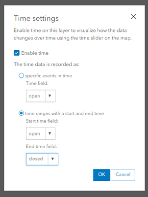

JasonBOCQUET
@IssyAmis @JenniferAcunto thanks both of you for your answer. It works !
Just for information, i've see this option but i don't understand it was usable for date things. I'm french and working with french language, but in french it's mentionned this option is for hour type of data.
In french the term of "time" is traduced by "time range" AND by "hour" so the traduction is "plages de temps avec une heure de début et de fin" can be traduced by "time range with an starting hour and an ending hour". So I thinked it was only for hour because the option ask me to use a "Champ Heure de début" or "Start Hour Field" if I want to traduce the terms literraly.
