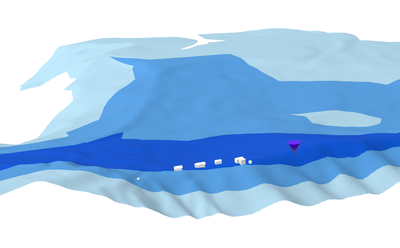

Thanks for sharing your webscene!
We looked into it  and your polygons coming from the SceneService (in absolute height) indeed intersect with the ground elevation.
When comparing the data in ArcGIS Online to the same scene in ArcGIS Pro, the latter also has such intersections but slightly less (it is easier to compare the difference when adding a dark base map to the scene). This difference is due to the ArcGIS Pro loading the elevation data in higher detail compared to the online Webscene Viewer.
Some workarounds that might help you:

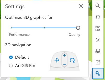

  • use the SceneViewer in high quality mode: this will use elevation data in a slightly higher detail (you need to reload your page to trigger the reload):
  • instead of using land-use polygons from a SceneService (that are set to absolute height), one could look for the same data as a FeatureService and drape them to the elevation (2D symbology with elevation mode: "On the ground").
  • If you need the elevation data for the surroundings but not for your focus area (because you use the SceneService polygons at an absolute height), you could make the focus area flat by publishing a custom elevation layer (here's an example scene with two elevation layers from the Living Atlas).
  • or (as discussed earlier in this thread) don't use any base map and make the ground transparent

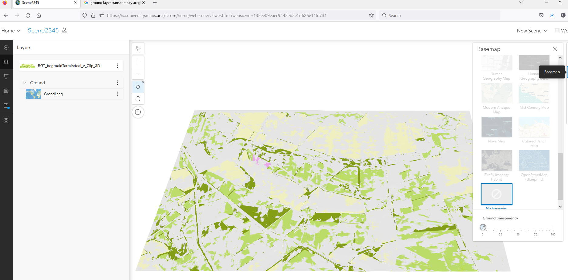

Thanks, But is there not a possibility to give the elevation layer GrondLaag no color instead of grey, without changing the ground transparancy? This one hasn't any color:
ttps://elevation3d.arcgis.com/arcgis/rest/services/WorldElevation3D/Terrain3D/ImageServer
I placed in ArcGIS Pro my layers on the ground on the grondlayer. Than i made with the layer 3d feature tool a 3D layer of the layers. and then i publish the map. In ArcGIS Online the grondLaag is visible on some places through my 3d layers.

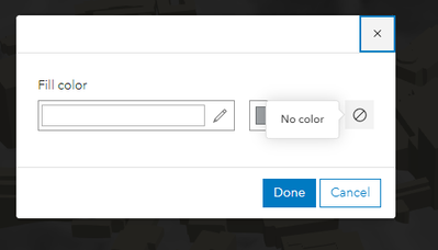

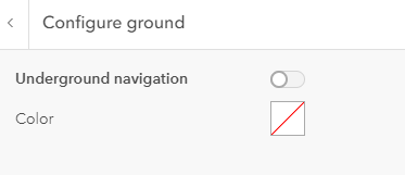

Have you configured the color under the ground properties
Click on color
Then select no color
WH1981
Thanks, yes i find that setting of the color. But i find it strange that the 3d layers are not staying on top of the ground like in ArcGIS Pro. The solution i now use is to give the 3d layers a offset of 1 meter. But its stupped that i must do that.

When i increase the quality level in the webscene the result is not very better.
