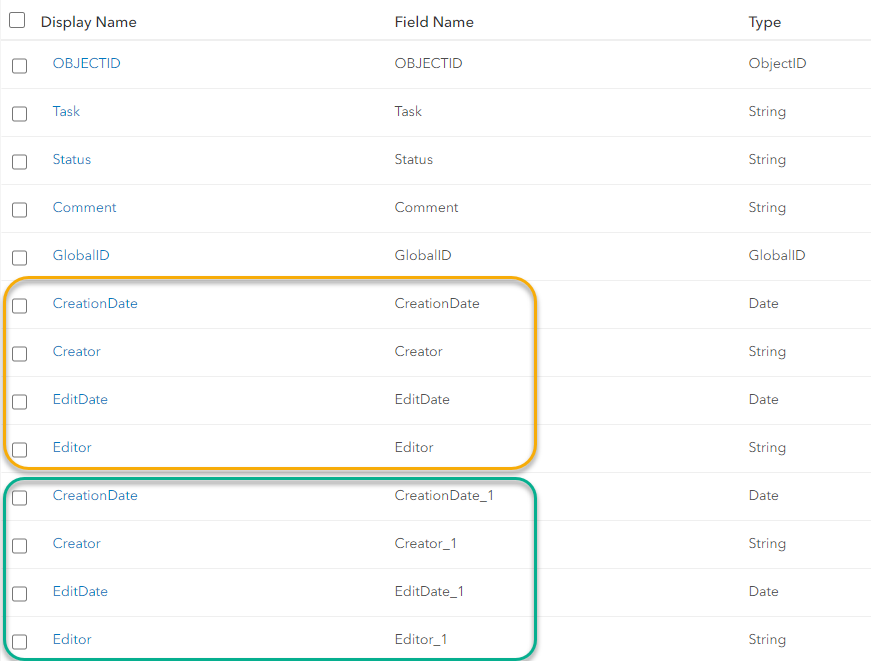

1. Currently, if you load an existing feature service into ArcGIS Pro, use the Export Features geoprocessing tool to save as a feature class, and then share the output as a new Web Layer, any Creator and Editor fields will be included with their original values but they will NOT be used for editor tracking. Once published, if you then enable editor tracking in AGOL on the new layer, it will create new fields for this purpose.

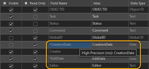

2. Also, you can't simply Export Features and use the included CreationDate and EditDate fields as they are now automatically set as High Precision fields (as indicated by the *). The Enable Editor Tracking tool will only accept Low Precision date fields, and there is no way to downgrade a field or change it in the Field Map when using Export Features.

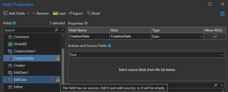

2. Use "Export Features" to create a copy of the data as a feature class in a File Geodatabase with the existing CreationDate and EditDate fields renamed (I've added a 1 to the end) and new CreationDate and EditDate fields created with no source field (set as Date type).
3. Use Calculate Field geoprocessing tool to calculate your empty CreationDate and EditDate fields from the renamed fields with original values.

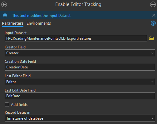

4. Use "Enable Editor Tracking" geoprocessing tool to register existing fields for editor tracking

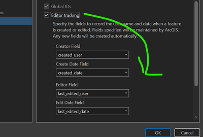

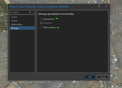

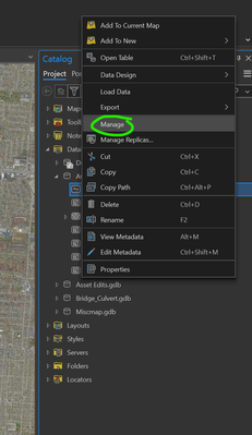

Preserving editor tracking has been something I have been working on in recent times, if I am just now turning editor tracking on for a hosted feature layer or exporting a hosted feature layer into ArcGIS Pro or making a new feature class and wanting to start having editor tracking on then.
If you export a layer into ArcGIS Pro (now feature class in GDB) or just create a feature class, go to the catalog and right-click the layer and go down to "Manage" here is where you can enable or verify editor tracking is on.

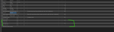

Once you enable you can leave this default, and it will create 4 new fields or you can set existing fields to have the editor tracking data go into, they must be the same data type***
Once you enable editor tracking you will be able to see them in the data design or if you associated editor tracking to existing fields then I believe the data design would like the same as before.
