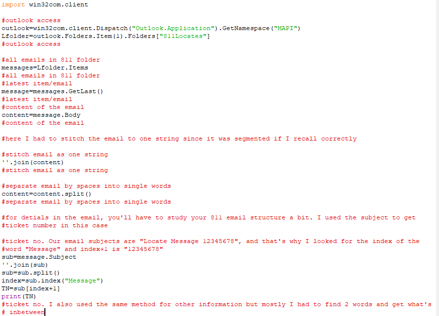

ZhongmingAn
I did similar stuff using pywin32 to access my outlook and 811 locate information. I have a function script and a trigger. I only have to run the trigger and it will be good for a couple of days before it stops responding or some error comes up, and I have to rerun the trigger, or even restart outlook sometimes. It will run the function every time a new email is sent to my 811 folder and add a polygon automatically to our online feature service, which can be accessed by our field crew. I'm using outlook so it probably won't work if you are not using outlook.
First of all, I set up a trigger in outlook to send all my 811 emails into an "811locates" folder
I'm in SD so our email format are a bit different but here is the python exampleMain_Access_Email.png
As for adding a polygon, I used arcpy instead of arcgis API since I lived under a rock. Here is the link to a tutorial: https://developers.arcgis.com/python/latest/guide/tutorials/add-a-point-line-and-polygon/
I think I just copy-pasted a trigger script from online and modified a few things and that was it. Here it is:Trigger.png
