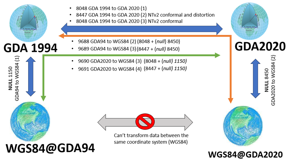

ArcGIS Pro is straightforward. It will attempt to project/transform layers to your map coordinate system, applying whatever transformations are set in the map properties. So be aware of default transformations and behaviours like when you add the first layer to the map, it'll change the coordinate system and potentially add transformations to your map properties. I doubt this has changed at ArcGIS Pro 3.2.
Transformations go both ways, so if it says 'GDA 94 to WGS84 2', it'll also go WGS84 to 94.
For your projection issues:
  • There is no actual transformation taking place 'to WGS84'. It's not considered an accurate coordinate system + stuff to do with time, so they just said that GDA94<>WGS84 is about right, +/- 3m
  • The same applies for 8450 GDA2020 to WGS84 (2). It's a null transformation.
  • So 'WGS84' data is actually just 2020 or 94 data dumped into the web coordinate system.
  • We therefore should consider WGS84 as WGS84@94 or WGS84@2020
So the only transformations - the shift that you are seeing - are between GDA2020 and GDA94:
  • GDA 1994 To GDA 2020 (1) - 7 parameter transformation
  • GDA 1994 To GDA 2020 (3) - NTv2 Conformal*
  • GDA 1994 To GDA 2020 (2) - NTv2 Conformal and Distortion*
So why do we have all these transformations? It's to help consistently align your 94 or 2020 data in WGS84. These days they are trying to get everything to align to WGS84@2020, so will encourage users to use projection paths like 'GDA94 to WGS84 (2)'. It's actually GDA94 > GDA2020 > WGS84, transforming your data to GDA2020. If you have a lot of existing data in WSG84@94, it won't line up.
In your case of picking 'WGS84 to GDA2020 3 + GDA 1994 to GDA 2020 1'
The WGS84 data is going WGS84>GDA94(null)>GDA2020>GDA94. It's also not clear if the WGS84 data is aligned to 94 or 2020 originally.
Confusing? Not really. All your data is 94 or 2020. WGS84 is just 94 or 2020, and mixing 94/2020 in WGS84 is what gives you the misalignment. identify if you're using 94 or 2020 and then follow the projection paths above to end up in the right desired coordinate system. Just note, never mix WGS84@94 and WGS84@2020, as you can't transform the same coordinate system.

You need to understand:
  • What coordinate system you are aligning your data to
  • What coordinate system your data is in
  • What transformation paths the data is taking, if any,
  • If working with WGS84, know if it is aligned to GDA2020 or GDA94, and take the appropriate transformation, noting that some are null and others have a hidden step through 94 or 2020
  • Working with a mix of WGS84 aligned to 2020 and 94 will result in a bad time (misalignment)
You also need to understand that the first three points will differ in different environments. For example, ArcGIS Online will align data to the basemap. It will use a default transformation to do this, but can also use datumTransformations specified at a service level from the time of publish. For a referenced ArcGIS Server service it's possible to have transformations between the GPS > Map > Feature Service > database.
We had a good 20 year period where the only transformation we had as a null one. Now we have options like the rest of the world, and it'll likely only get more complicated with epoch/vertical stuff.
Will this matter for you? Maybe?
  • End users get confused / doesn't look professional when your datasets are in misalignment
  • WGS84 isn't accurate anyway, basemaps are an ensemble. We get feedback about trees features not aligning to imagery, when the feature from high-accuracy GDA GPS, and the imagery location will change if you switch basemaps/imagery service providers.
  • Editing and snapping/geofencing/seeing if location falls within a boundary is an issue
  • Spatial analysis can be off if your data is not geometrically coincident
Talked about this at a Georabble event in Sydney and kicked off a few good conversations around accuracy/precision and communicating this to GIS and non-GIS stakeholders...
Easiest way to avoid all issues is to stick to one (GDA2020) coordinate system all the way through. Get high-accuracy GPS if you can afford it. GDA2020 locally. If going web, WGS84@GDA2020 in web GIS accepting some level of inaccuracy against the web GIS backdrop, and understand the implications when publishing from Pro.

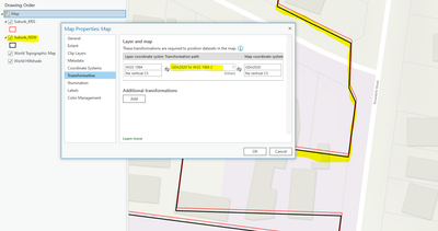

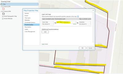

Bryan_krg
Hi @ChristopherCounsell,
I have a similar problem with transformations. We might have incorrectly projected our layers and I'm not sure if we can fix it easily. An example of this is attached. There are 2 suburbs layers one we tried to project into GDA2020 MGA56 called Suburb_KRG. The other is called Suburb_NSW and is downloaded from the state. It's also in GDA2020 MGA56 however they do not match...
If we choose WGS84 to GDA2020 3 as the transformation our data matches the basemap and the state suburbs don't match.
However, if we choose GDA2020 to WGS84 2 the reverse is true. The state suburbs match the basemap and our data doesn't match.
Could you please explain what is happening here. I fear one of these layers is still in GDA94 but now says it has a GDA2020 projection. If so, is there a way to correct this?
Thanks,
Bryan
