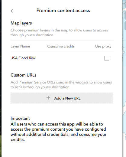

You can setup access to this content in the Web App Builder. To do so go to the "Attribute" section then click on 'Premium Content Access". This will bring up a form that allows you to create proxy for premium or subscriber content in the map or specify a custom url to proxy.

Hi. so the webmap in question was already in a Webapp and that option to allow access to Subscriber Content does not appear when you are using Web AppBuilder.

KellyHutchins
Esri Notable Contributor
JenniferMinnick
So...if I don't use web appbuilder I just click a checkbox.
If I use web appbuilder then I am using a proxy (that I don't actually have to set up??) but that's probably what the checkbox is doing in the configurable web apps.
I would guess that doesn't have the consume credits icon because it's subscription content but not premium content.
The help page for this (now that I know what to look for!) is Attribute—Web AppBuilder for ArcGIS | ArcGIS
This solves the problem - thank you for the clarification.

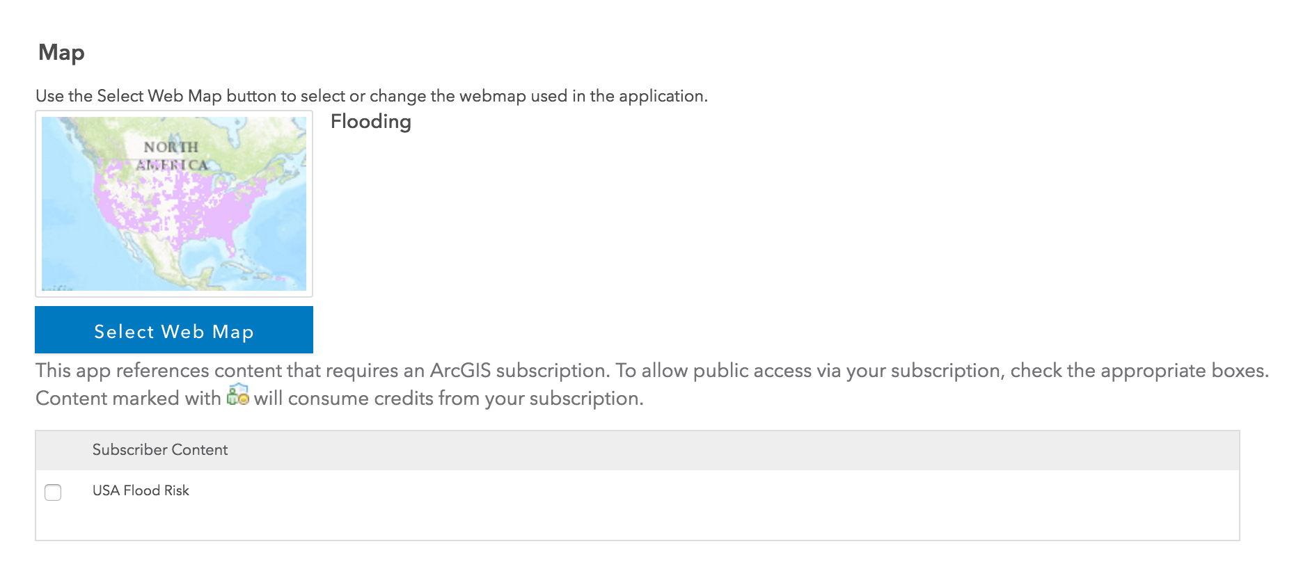

KellyHutchins
One option is to share the web map as an app using the Share > Create a Web App option in the ArcGIS Online Map Viewer. When you do that you can configure the app to allow anonymous users to view the Living Atlas content. Here's a screen shot showing the dialog on the app config. Just check the checkbox next to the layer you want to make available then share your app publicly and users won't be prompted to log-in.
