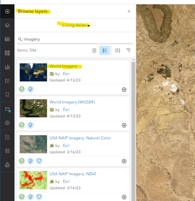

If you add the background imagery as a layer from AGOL, the Living Atlas, or if your organization publishes its own imagery layer as a service that you can control the zoom scale this way through the layer's property sheet.
