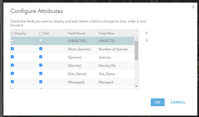

Katie_Clark
MVP Regular Contributor
Yeah, I still use Classic Map Viewer as well for compatibility reasons. Just change the alias in the attribute configurations menu
