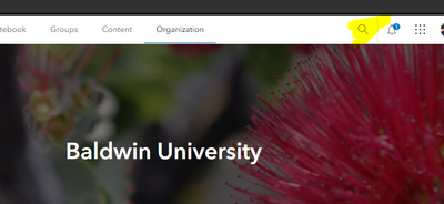

BrianBaldwin
Just drop that ID into the ArcGIS Online search pane - and it will return the item.
Then - make sure that is shared 'with everyone'.
