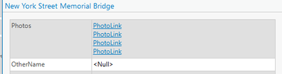

Also in ArcGIS Pro, I configured the popup with an Arcade expression so it properly displays, with HTML line breaks built into the table. Here is the popup in Pro:
Uploading this to AGOL, the popup doesn't work -- it just shows the html garbage. The case where it actually does work is when there is a plaintext url (no html from the table itself) and there is 1 record. The link text defaults to "View."
BUT when the related table has more than 1 record for a particular location, the multiple records' plaintext urls are concatenated, which of course screws up the link and defeats the whole purpose of relating a table.

BryanPreston
Thanks @Charles_Blanchard,
The first link does provide a decent workaround. A new problem arises, however, when there are many related records that need linked to. For example, there are a few locations in my dataset that are linked to 100 photos, though the large majority only link to 8 or less. If I wanted to display links to ALL photos, then this solution would necessitate displaying 100 individual photo fields for all popups, with those fields almost all those fields blank for all but a few locations.
For now, this can work for my needs, as we can get by not displaying all of the photos for the few locations that are related to an unreasonable number of them. As I understand it, Experience Builder provides more customized options for popups -- but I'm still not sure if there will be options beyond a workaround like this.
