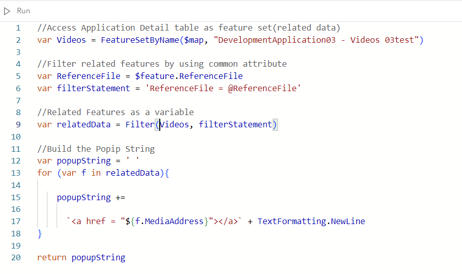

I'm working with a map in ArcGIS Online where I have a feature layer and a related table. I'm trying to create an Arcade expression to display links from a field called "Media Address" in the related table within the popup.
I've tried the following Arcade expression, but didn't work as expected:
I'm getting the link addresses from the field "MediaAdresses" from the related table as text and not as "Links" 😞
So I'm looking for assistance in refining this expression or suggestions so I can get the actual link from this field from the related table.
Any insights or alternative solutions would be greatly appreciated! Thank you

If you want a working link, you have to use an Arcade element. Here's one example of creating a popup with links from a related table
var related = FeatureSetByRelationshipName($feature, "DCGIS.SURDOCS");
var relatedCount = count(related);
var output;
if (relatedCount == 0) {
  output = `<p>There are no surveys for this property.<\p>`;
} else if (relatedCount == 1) {
  var rec = First(related);
  output = `There is 1 survey for this property:
    <br>&nbsp •  <a href="${rec.FILENETLINK}">${rec.DOCGUID}</a>`;
} else {
  output = `There are ${relatedCount} surveys for this property:`;
  for (var rec in related) {
    output += `<br>&nbsp •  <a href="${rec.FILENETLINK}">${rec.DOCGUID}</a>`;
return {
	type : 'text',
	text : output

JohnEvans6
Try returning popupString in an object?
return {
  type: 'text',
  text: popupString
The formatting of your anchor tab looks a little off also since you're wrapping the field in quotes. Maybe something like:
var maddress = f.MediaAddress
popupString += `<a href = ${maddress }>Media Address</a>` + TextFormatting.NewLine
