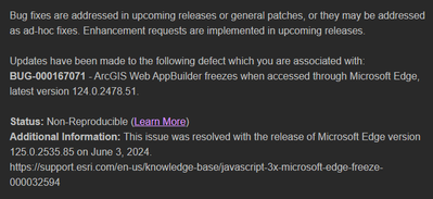

Apparently this was fixed with the last release of MS Edge:
Quick tests shows it works indeed.
