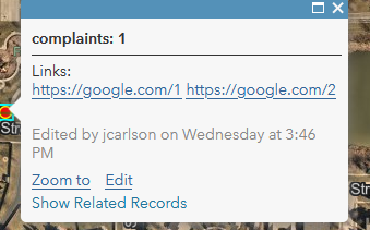

a feature with two related recordsa feature with two related records
a feature with a single related recorda feature with a single related record
I didn't have a URL field, so I just appended the ObjectID to "google.com" to test, but it should work the same.

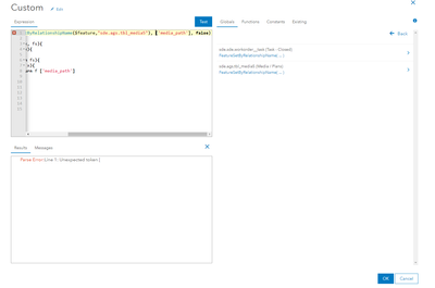

Thank you very much!  I am a newbie at Arcade, but I get this error:
jcarlson
MVP Alum
You have an extra ')' in the middle of that first line.

KellyArmstrong
Ah ha!  I deleted it and it works great!  Many thanks, on this long Friday!

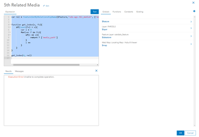

I have an interesting observation/question for you.  I followed your above code and it works wonderfully.  The problem I have now, is that when I go back to my expressions and test them, I get an error.  They still function in my webmaps, but when I test them, I get the attached error.  I also can't copy the expression to make another one because of the error.  Did something or an update happen to Arcade for this to no longer function?

Esri must have had a recent update, because as of today, I no longer get any error...
jcarlson
MVP Alum
Oh, good! Sorry I didn't respond to your earlier post, I've been out of the office for the past week. Glad to hear that the error went away on its own, though.
