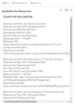

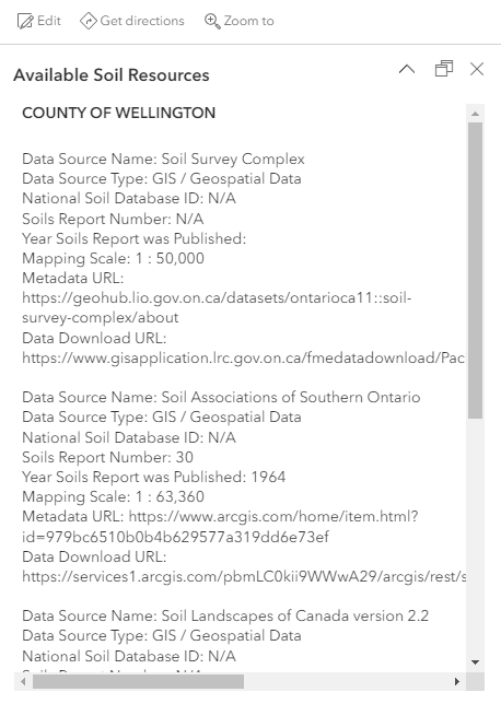

I have a feature service that identifies where we have soils data / resources.  I have a related table that provides details to all of those resources.  I am trying to configure the pop-up so that all the details appear when a user clicks on a polygon.  The code that I use is included below:
var tbl = OrderBy(FeatureSetById($datastore, "1"), 'Data_Source_Type DESC');
var primarykey = $feature.GlobalID;
var sql = "ParentGlobalID = '" + primarykey + "'";
Console(sql);
var relatedrecords = Filter(tbl, sql);
var popupString = ''
for (var f in relatedrecords){
    popupString +=
        "Data Source Name: " +
        f.Data_Source_Name + TextFormatting.NewLine +
        "Data Source Type: " +
        f.Data_Source_Type + TextFormatting.NewLine +
        "National Soil Database ID: " +
        DefaultValue(f.NSDB_ID, 'N/A') + TextFormatting.NewLine +
        "Soils Report Number: " +
        DefaultValue(f.Soils_Report_Num, 'N/A') + TextFormatting.NewLine +
        "Year Soils Report was Published: " +
        f.Publishing_Year + TextFormatting.NewLine +
        "Mapping Scale: " +
        f.Mapping_Scale + TextFormatting.NewLine +
        "Metadata URL: " +
        f.Metadata_URL + TextFormatting.NewLine +
        "Data Download URL: " +
        f.Data_Download_URL + TextFormatting.NewLine +
return popupString;
It gives me exactly what I want.  The only thing missing is some formatting.
For example, I would really like to have the field headings bolded and have my hyperlinks displayed properly.
I've looked into Arcade Pop-up content elements but am unfortunately struggling to wrap my head around it.

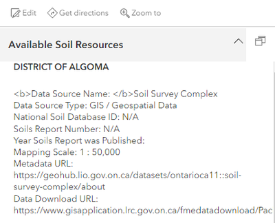

@MarkChappell Thank you for your response.
Unfortunately it does not recognize the HTML tags.  It treats it a regular text.
    popupString +=
        "<b>Data Source Name: </b>" +

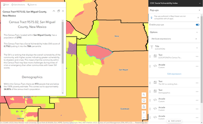

Ohhhh okay. I ran into this issue previously, and ended up choosing the messier solution. Instead of using a single expression, I added multiple content attributes (a variety of switching back and forth from Text to Arcade).
This is what I ended up doing for the solution:
var percentile = Round($feature.RPL_THEMES * 100, 0);
var suffix = '';
if (percentile != 11 && percentile != 12 && percentile != 13) {
    var lastDigit = percentile % 10;
    if (lastDigit == 1) {
        suffix = 'st';
    } else if (lastDigit == 2) {
        suffix = 'nd';
    } else if (lastDigit == 3) {
        suffix = 'rd';
    } else {
        suffix = 'th';
return {
    type: 'text',
    text: 'This Census Tract has a Social Vulnerability Index (SVI) score of <b>' +
        $feature.RPL_THEMES + '</b> putting it into the <b>' +
        percentile + suffix + '</b> percentile.<br><br>'
 It ended up with the following results.
Not sure if this is the solution that you're looking for, but it is at least, a solution.
Hope this helps!
