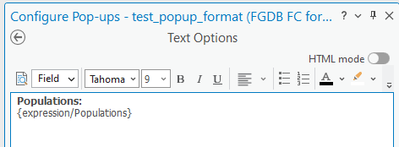

I have a simple text popup that displays this expression:

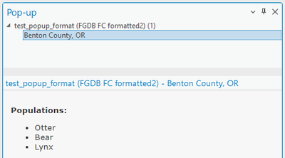

The popup renders the HTML in Pro as expected. This is just dummy data for testing, but the field value is "Otter; Bear; Lynx". Here is what displays:

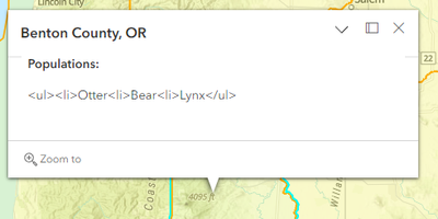

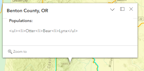

When I share this to a hosted feature layer in ArcGIS Online, the expression comes across fine under the new item's "Visualization" tab. When I click on a feature, the expression runs and returns the HTML, but the popup just renders it as text.

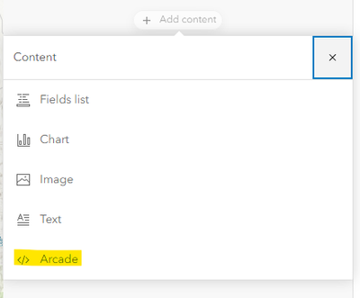

After failing to make it work with a text element and expressions, I got something similar working as an Arcade element. I couldn't figure out how to consume the expression there, so I recreated the expression as functions. This approach did render the HTML in ArcGIS Online, and it also worked when I added that hosted feature layer as a Pro map layer.

Question: Pro renders HTML returned from an expression in the popups, but ArcGIS Online does not. Is there some way to get that to work, or is that just a limitation?

I had a similar problem a few months back; we had a popup that worked fine in Classic Map Viewer, but not the new one. I want to say I found a document saying HTML expressions are not recognized as such in Text element, but memory is a little hazy at this point...
I wound up doing what you did in an Arcade element. Afterwards I made the functions generic enough that I can re-use them wherever, and now I don't bother with Text; pure Arcade is less work to setup and easier to maintain for what I need it for. Definitely prefer the AGOL editor too.
