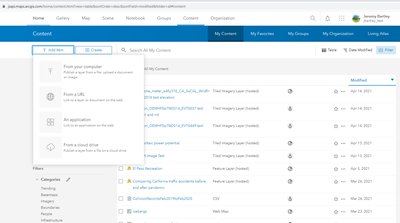

Loading from My Content is still your best bet.  You will get better performance and you will have no limit on the number of features you can add.  It is independent on which map viewer you chose as your default.
That being said we will in the future have a way to upload local files directly in the new map viewer.

Your best bet for loading CSVs into Online is to load the data from your My Content page.  Doing it this way creates a hosted feature layer that has virtually no size limits on the amount of data you can load.  Loading a CSV in Map Viewer Classic will add the features into the web map and there is a strict limit on the number of features you can add this way (for performance reasons).  This assumes you are a user in an organizational account and can create hosted feature layers.
The new map viewer will eventually have a way to make this seamless and integrated within the app itself in a future update.    So stay tuned!

In the November release of Online you will have the same add experience in the new map viewer that is in My Content.  This will allow of direct publishing of the files from the map viewer.  In addition, that experience will allow you to host the geojson/csv files that can be viewed without publishing to a service (if the user can't publish for instance).
