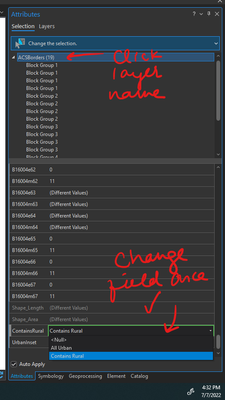

If you do have Pro available, add the layer from your portal, select by attributes where Inspector = Employee D OR Inspector = Employee E, and from the attributes pane, ensure the layer name is selected (not the individual features) and make the change. It'll update all the records.
Paul_Keidel
@wayfaringrob  I was aware that AGP could reach out to AGOL files but was unaware that the List of Values entries could be selected and changed. Wow! Then other than waiting a few minutes for the AGP changes to propagate up to AGOL, this process worked just fine. Thank you for taking the time to help and teach! 😄
