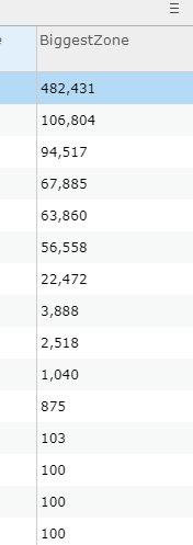

I've used this field calculation on almost 25000 records.  For some reason 12 records have created results which fall outside of the expected results.  The results are turned into a percentage and should be between 1 and 100.  Using the very same expression within the popup show the expected results, but some how it is the field calculator that has skewed a few of the results.  I cant see any reason why it should have done this!  I tried to run the calculator again on it thinking it might have timed out but I still get the same result.

Hi njbegg ,
Can you share the formula that you are using to create the percentage and in case of the 482,431 the values used in the calculation? Another thing to remember is that when you do an intersect even touching polygons will be included in the intersect. I have used a negative buffer in the past to avoid this from happening. See additional explanation here: https://community.esri.com/docs/DOC-12773-using-featuresetby-functions-in-arcade-to-drill-down-to-ot... (just scroll down to the end of the article).
