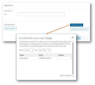

WhereMatters
Hi Josh,
Yes, in AGOL there is a certain spot where we can see credits consumed by the application. Here is a screenshot of the place where I typically see the credits for each application. But I am unable to locate how to get this using Python API.
