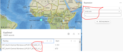

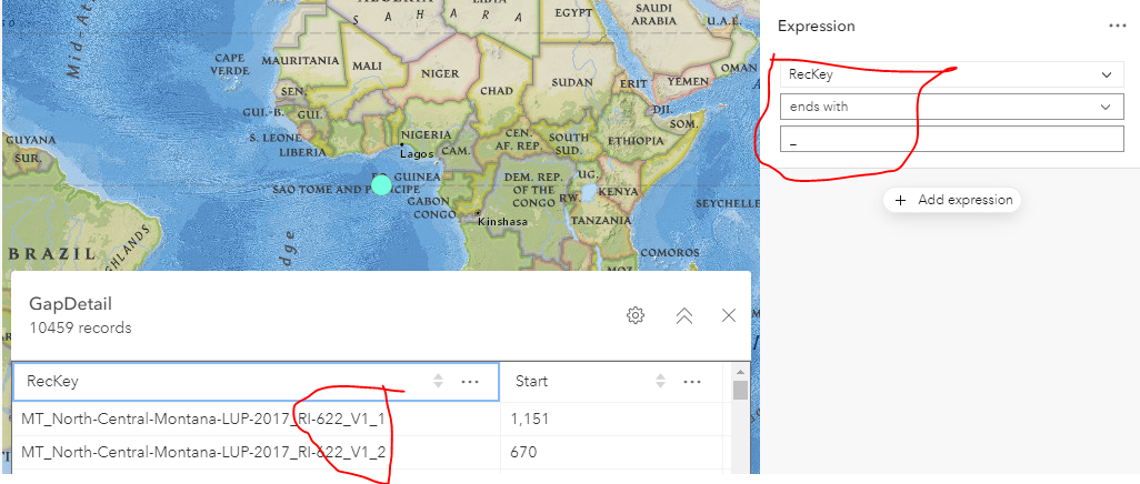

The New Map Viewer does not handle underscore correctly in a filter.  It seems to do nothing.  Looks like maybe escape was not programmed in?  I just checked and the classic viewer does not work either.

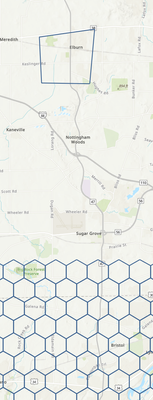

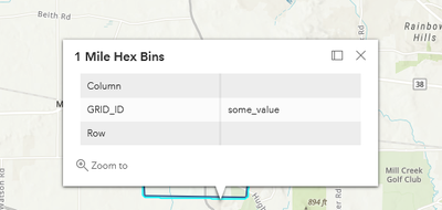

Here's a feature w/ an underscore.
Filtering for "contains _":
(For the record, those other features do not have underscores.)
Filtering for "contains [_]":
