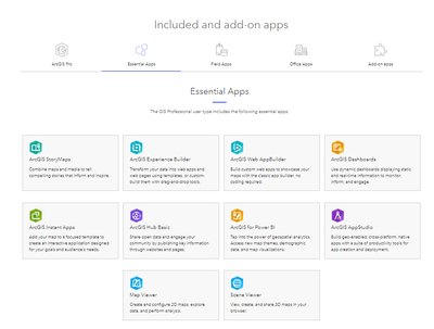

Do you mean the widgets in Web Appbuilder?
or you are referring to the app licenses / app bundles included in each User Type?
e.g.

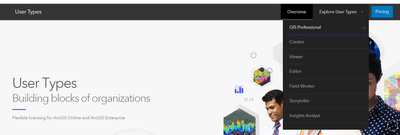

You could visit User Types for ArcGIS Online & Enterprise Licensing (esri.com) and drop-down "Explore User-Types" to view different apps that are included and supported add-on for each User-Type.
Think Location
burrkim
Hello,
I'm looking at the widgets in the Apps. I've looked in both of these places and neither show a list of the widgets available to that user type.
