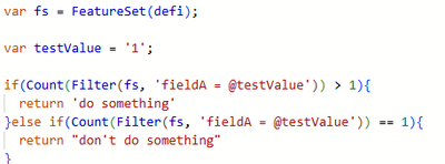

For a featureset that looks like that following:
You could call the value of your cell as a filter on a given field of the feature service and use the "Count()" function on the filtered feature service to determine if the value is appear multiple times in a given column. Like below:

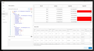

You don't need to add the UniqueCount field to the Value fields when setting up the table, but you'll use that field in the Advanced formatting tab. In this example, since all the Depth_ft values in my test table have multiple instances, I'm highlighting those that have more than 10 instances in line 1
var bgColor = iif ($datapoint.UniqueCount > 10, '#ff0000', '#ffffff')

That yields this table
