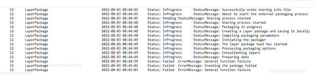

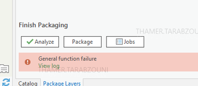

The problem when I use the option to share it as a layer package so I can then view it in ArcGIS Online, I got the following errors despite the analysis step is successfully completed. It seems I'm missing something

you will need to share this as a web scene and publish a scene layer during that process. layer packages are not viewable in web apps.

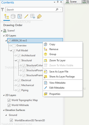

This is what I know, but the only options displayed are presented below. and ArcGIS Online doesn't open .Lyrx files.

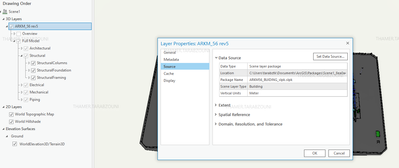

When you go to properties on the BIM layer what is the source for it?

Hi, Sorry for my late answer .
I'm note exactly sure what is your question about, but hopefully the below screenshot would be providing that.

RussRoberts
Esri Notable Contributor
That is a scene layer package. You can do either Share Web Scene which will upload that package and publish a scene layer from it or upload that package directly through ArcGIS Online> My Content > Add Item
