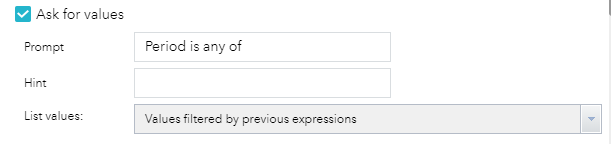

Hi Doug Browning‌,
Try adding a set through the filter widget, with your expression choose unique values and in your list values options choose values filtered by previous expression. See below. This should filter the responses of the following expressions in the set and move the map dynamically if you choose to do so.
Shane
If this answer was helpful please mark it as helpful. If this answer solved your question please mark it as the answer to help others who have the same question.

Thanks but I was looking for a Web Map solution not a Web App one.   Not sure why app has it and map does not.
