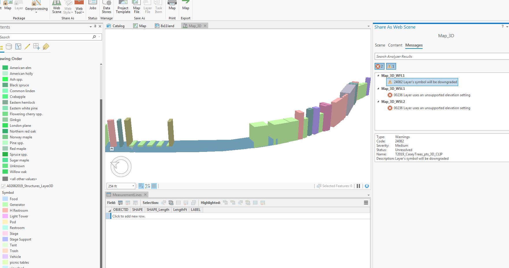

How can I address error 00236 - I am using the supported elevation settings, and am still getting this error, so I can't publish online and am at dead end.

I have spent a full day messing around with this to try to create a tool for planning purposes.  I am continuing to get errors on my layers "unsupported elevation setting" even though both are set to on ground, which is supported when I looked into error 00236 fixes.

I have the same issue: 00236: Layer uses an unsupported elevation setting.  Were you able to resolve the issue?
DarlaPyron3
Same thing was happening to me and I found this. I wanted On the Ground but I guess it isn't supported at 2.9
  • 3D Multipatch layer shared as a web scene layer
    • At an absolute height using Geometry z-values.
