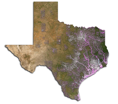

One way you can solve this is by using blend modes in Map Viewer. Here is a sample I tossed together using the imagery version and I removed the not mapped values under layer styling:
I created this clipped area by have these three operational layers grouped in a group layer and in this order

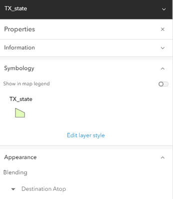

Then on the TX_state layer I set the blend mode to destination Atop under the layer properties panel
and then you are set.
