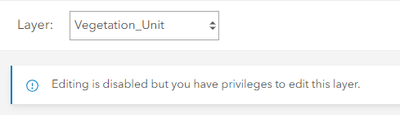

Hi, I have a frustrating situation where I am suddenly unable to create an editable hosted view from a source editable hosted feature service.  This is a hosted service where I have previously created several editable views without issue and those continue to work.  However now, no matter what options on the view definition or edit settings that are set a newly created view is not editable.
Looking at the REST endpoint for the layer confirms that although there was no error setting the editable checkbox on the view, the capabilities property does not include Editing and there are no ApplyEdits endpoints on the layer.  At the root service, however, these settings are present, but they do not get applied to the layer in service.
I am not sure if this is related to last week's update or not but it seems like this has come up from time to time in the forums and the only solution has been to completely republish the source service again; however that is not an option with this one.
Appreciate any thoughts on this at all.  Thank you!
Sam
