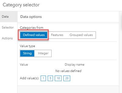

Manually define the values for you filters using Defined values:
This way the application is not querying the 300,000 rows to retrieve the 20 values.
