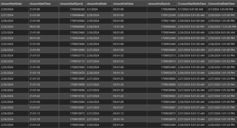

I have web service that is showing road closures that usually last less than a day. I am trying to find a way to only show the closures on the map that are active, so after the start date/time and before the end date/time.  I have been trying to accomplish this by  using an arcade symbology expression, but I can't figure out. Says the expression is right but doesn't show the closures I want on the map.
Is this the best way to accomplish this?  Does anybody have an idea on how to best set up the expression?   I have 3 types of date time fields to choose from, I can't figure out any of them out.   I have attached an image of the field options I have.

These are the Start and End Date/Time fields I have to choose from.
